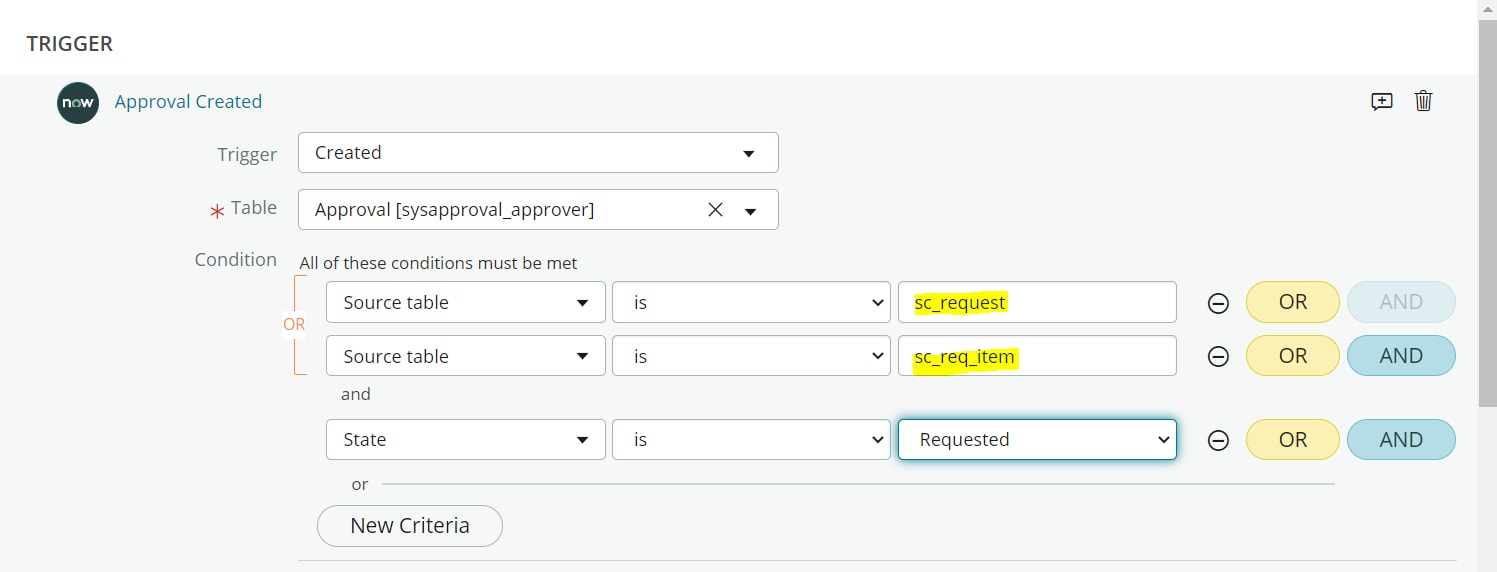

Now the above article is common to approvals from all the tables. so for the Trigger Condition you need to add some additional conditions so that it will be triggered only to your sc_request or sc_req_item table.
In the above screenshot, I have set the trigger to run only for the sc_request and sc_req_item table. you can configure it as per your need.
