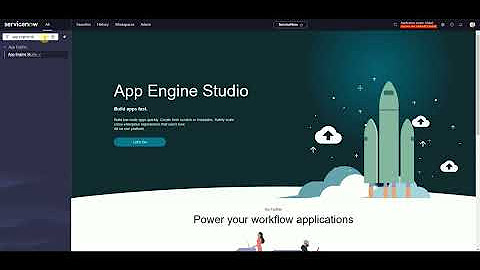

there is OOB Configurable Workspace that is ready-to-use with the Inbox of Advanced Work Assignment.
If you want to create your own custom Workspace, setting up the Inbox is not so straightforward as it could be.
Here you can find step-by-step guide how to set it up.
https://www.youtube.com/playlist?list=PLDLTlm2deb9tbyuQ5ul5OIleUWT3EZFKo
I hope it helps 😉
