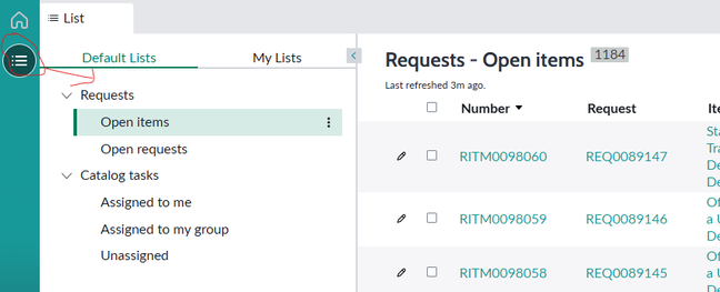

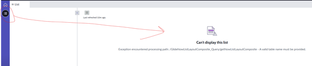

I have created a simple custom workspace in UI Builder, it has a landing page, list page and standard record page.  However, when I impersonate someone who will be using the workspace, when clicking on the list menu, an error appears.  It doesn't appear when I click on it.

Impersonated person sees this:
I see this:

Voona, you were partially correct.  I used the link you provided and looked at it closer, I was missing the last step for a list page - I needed to configure the M2M Applicability.  Once I did that, it worked!
Thanks so much for pointing me in the right direction, I've have spent days trying to find the answer.
