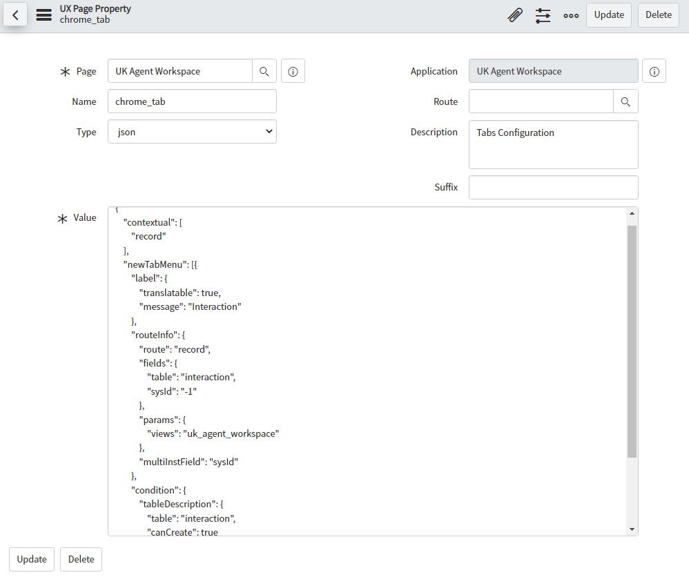

07-04-2022 07:15 PM
Hello
Attached picture shows the "Add" button and what's inside of it, the New Incident and New Interaction. I want to include my created table. How to do that? Thank you
Ejay
07-06-2022 12:17 AM
Hi Ejay,
I think there are required some steps to configure for your workspace:
- Go to UX page Register (sys_ux_page_registry) of your workspace:
- Go to chrome_tab properties:
if this is not existing, you just create new one (must be the correct name) - The value of this property, you can see this blog(section 5):
https://nowtektalk.blog/2021/03/10/servicenow-uib-page-properties/
Hope this will help!
