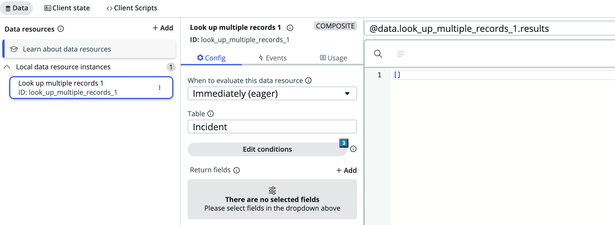

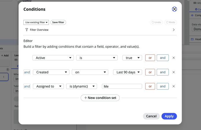

@gowthamaa_mohan please find below 2 images, where I have added a OOB data resource "Look Up multiple records" and given the conditions as what you have mentioned in your Data script above.
This will give some output in an array. If that Array length is zero, then in that case, you will hide the Data viz. component.
