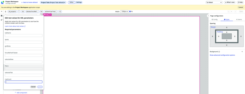

For the New Project Workspace,  I'm looking in UI Builder at the Project Tabs (which I think operates the list view).  I have a business requirement to remove the New Button but the page is showing Paramters that I'm not sure what to put there.  Does/Can anyone help with this? I thought I could get them from the Project Workspace and I'm getting nothing.

Can you show the components on this page as your preview input box is hiding all the component hireacrchy on UIB page. If it's a list page it's most likely coming from the List Actions where for the project table New button has been configured.  Uncheck this Enable declarative actions checkbox.

Here what you see is the values that you require to input to see the page. These are required params without which you can't preview the page. Open the workspace directly and check the url of this specific page in the workspace. you will get the test values.

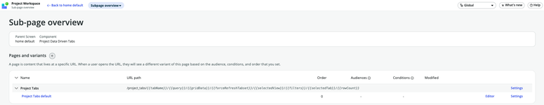

where is the new button which you want to remove and why do you need these paramters at the first place. these are required parameters for the project tab subpageScreenshot 2024-12-06 at 6.42.07 PM.png

This is in the List Controls in UI Builder and without the parameters to put in to get something to show on the list.  I can't see any of the controls on the form.

When I go into UI Builder here is the subpage (showing nothing) without the parameters filled out.
(Screenshot of Subpage where the list controls are probably at)
As you can see after looking at this in editor (see below) the page has nothing on it without data
