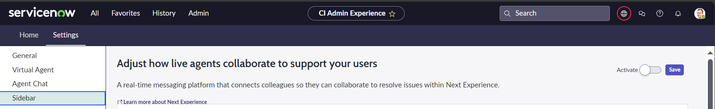

I have to removes discuss from servicenow UI Next Experience Header. Is there any way to do it?

Hi @Sneha Anil2 ,
please follow below points and refer some images also....
Firstly , Select Application Scope : Omni-Experience Standard Feature set, then
- Navigate to All > Conversational Interfaces > Settings.
- Select Sidebar
- Activate Sidebar by Disabling the Activate option.
- 'Save'

05-08-2024 03:44 AM
Hi Adarsh,
I did what you suggested but its still there only I tried logged in again also.
Is something other also need to be done?

Hi @Sneha Anil2 ,
Whatever I have suggested to you, I tried it in my PDI.
I followed same steps...
Go to Conversational Interface than Setting after that select Side bar and drag off than Save.
Please try once again to select Home workspace and refresh page..
I hope it will work

Hi Adarsh,
I did on my PDI only on which version your instance is in?
