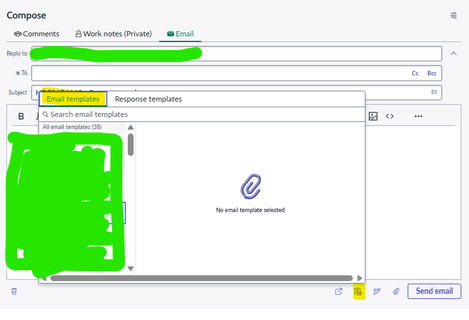

Hi everyone,
It might seem simple, but I can't remove the 'Email templates' option from HR Agent Workspace. When I click the 'Compose email' button, it always appears even if I remove it from the contextual side bar.
Print below for reference:
Any ideia on how to remove this?
Thanks in advance!

Hi @Ankur Bawiskar ,
That will remove the entire 'Email' component. I just want to remove that 'Email templates' tab not the email sending configuration.

@Ankur Bawiskar This is HR Agent Woorkspace. Trying to remove that tab only and ServiceNow isn't very clear on how to do so.
