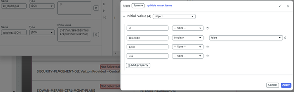

Here is the config of the items I'm working with... starting with the JSON object definition (client state).
Client State Config
I have defined the client state object with the same 'keys' as I'm setting with my client script. For what it's worth, I also tried leaving the object completely blank (same outcome).
