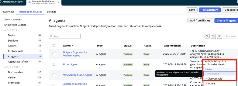

warren_chan
Are you sure you are in Washington or Vancouver? These are greater than N-2 releases and should be deprecated by now.
In addition, Now Assist Panel (NAP) should align to invoking Agentic Workflows, and conversely, Now Assist in Virtual Agent (NAVA) should align to invoking standalone AI agents. It's possible you have some early release config in place that enables you to invoke AI agents in NAP, but these aren't common situations.
Try going to Virtual Agent > Designer. In the Assistant Designer, for each conversational assistant, like Now Assist Panel, walk through the wizard again. Then in the Information sources, verify that the AI agents or Agentic Workflow appears.
Mine is currently maxed out in terms of promoted assets:
warren_chan
