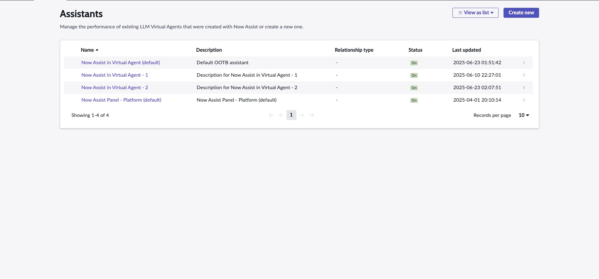

Hi @tidert_24 , I see that your panel is activated and you are seeing a virtual agent at some portal which you don't want.
Fo resolving this you need to check for all the Assistants (Now Assist) which have included that particular portal in the "Display Experience" thing as shown in the below pictures. Once you find the Assistant , just remove that portal from the Display Experience.
Let me know if this solved your issue and do accept this as a solution along with marking this as helpful.

Have you tried the following:
  1. Sidebar requires the Omni Experience plugin
  2. Now Assist Admin > Experiences and then ensure the Now Assist Panel is "On"
    • Click the "CI Admin Console" and ensure the "Now Assist Panel - Platform" is On
