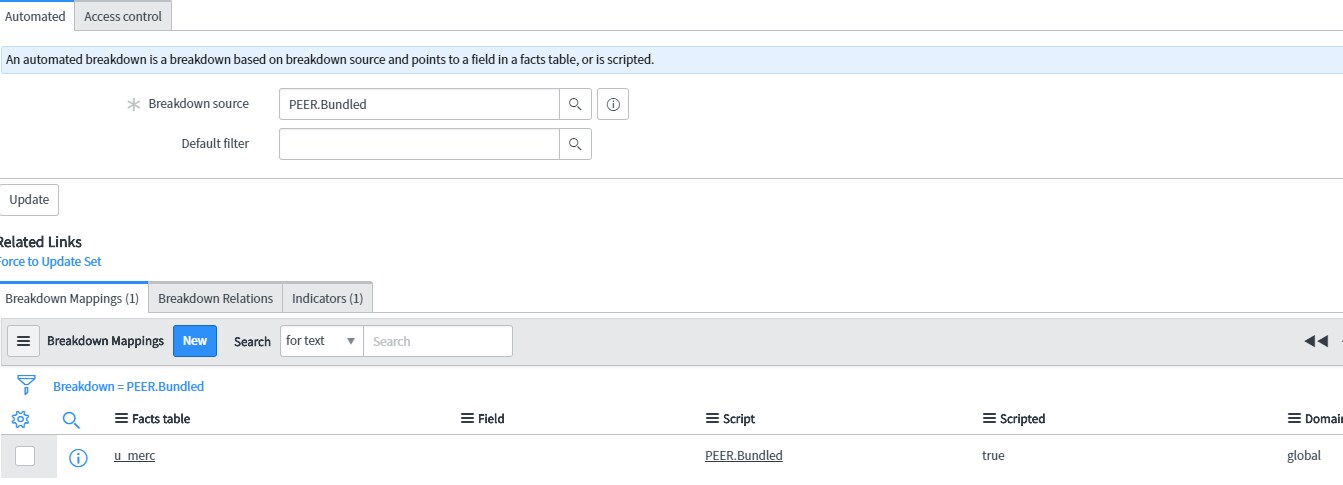

I am trying to create a breakdown for a group of existing indicators that will separate based on whether a field is empty or not. This is currently a text field, so it is not something I can use a normal breakdown for and have tried using a bucket group. I do not want to create additional indicators and stack them as there are many, and I am already doing some stacking- the breakdown method will be cleaner, but I think I am missing a step or just have a bad script.
I created a bucket group-
I created a breakdown source-
And finally I created an automated breakdown-
Unless I am missing a step, which is entirely possible, I think the problem is likely my script since I am a scripting neophyte- I have tried to create this based on what is OOB and some googling.

‎06-07-2018 10:05 AM
Don't mask the problem in PA. Fix the data in the base table (most likely by adding a true/false field). This will allow you to simplify your breakdown but also allow you to use this:
- In reporting
- As an interactive filter
- In a Business Rule
- Any place else you may need it in the platform
If you have no other options, you should be able to fix your bucket definitions. It should be null/blank to 1 and then 1 to null/blank.
‎06-08-2018 07:58 AM
Thank you for the reply Adam. Actually, there are reasons why I cannot add a field to the table. I would need to go down a change control route to edit the table, and we are on a partial freeze in that regard. I can however do whatever I wish with PA.
I tried changing the bucket group to null - 1 and then 1 - null, but get similar non-results when running a collection (no scores).
Thanks!
Jeff
‎06-08-2018 08:37 AM
1) Taking the shortcut by using a script is fine for a quick response, but it is not a good long-term solution. As long as you are OK with, let's get it to work.
2) What does your entire script look like? It looks like you put in just a snippet of it.
3) Put in some gs.log() statements to make sure you are getting what you think you are getting in your script.
