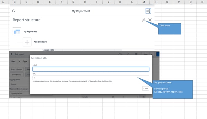

Hi
I find the way like my screenshot. But I did it for service portal.
