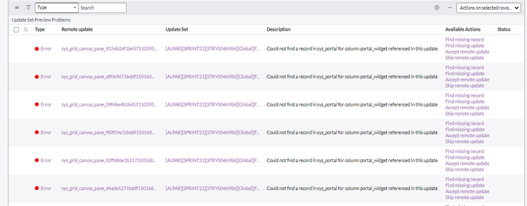

Error: Could not find a record in sys_portal for column portal_widget referenced in this update
divyasurada
While trying to move update set related to dashboard to test instance.
I am getting below error even though i captured portal pages and grid canvas.
Please help
Thanks in advance
Divya

Hello Obul,
In my case I've unload the dashboard and moved it to the test instance and the error still appears:
I just need to move this filter (update) to test instance:
It's a Custom Interactive Filter. This filter is not being updated in the test instance dashboard. The error that appears when uploading the update set is the one in the first image.
I need help please.
