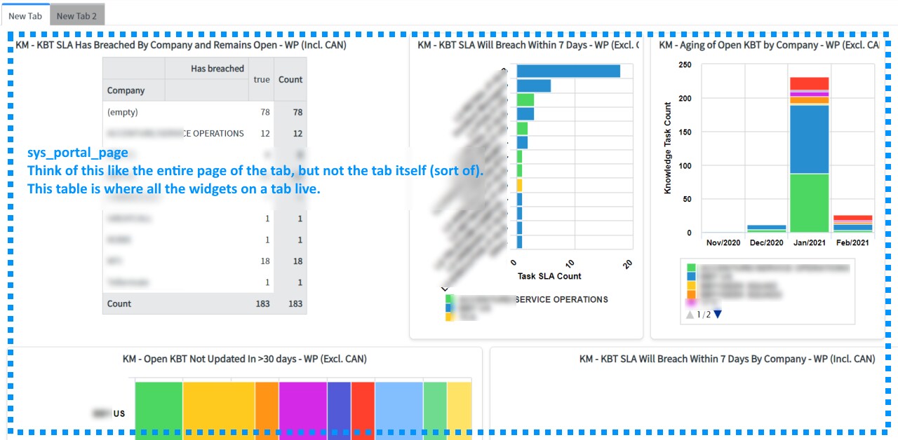

  7. Now we have to dot-walk up through a few tables to find the sys_id of the Page it is on (think of the sys_portal_page as the layout of all the widgets on the dashboard tab).
  8. Click on the sys_id that appears in the Portal Section column (it is a reference!) to open the Portal Section record (sys_portal).
    1. Think of this as the widget container that you can drag around on the dashboard.
  9. Open the record for the Page field.  You will now be on a "sys_portal_page" record.
    1. Think of this as the entire page of the dashboard tab.  Where all the widgets on the tab live.
