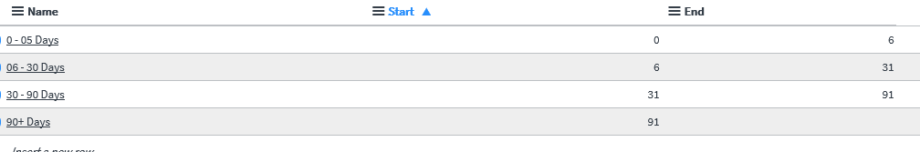

Go to Breakdowns --> Bucket Groups
Click on Incident Age Ranges (Days)
You can customize your day ranges/buckets there - Note the numbers are far to the right but you can get the idea. The 0-5 day one has a start of 0 and an end of 6, 6-30 start of 6 with end of 31, etc.
Then just apply to your indicator. For the Indicator, I'm using a Breakdown, type = column, sort on Name, sort direction = Descending. Gives a nice clean column chart.
