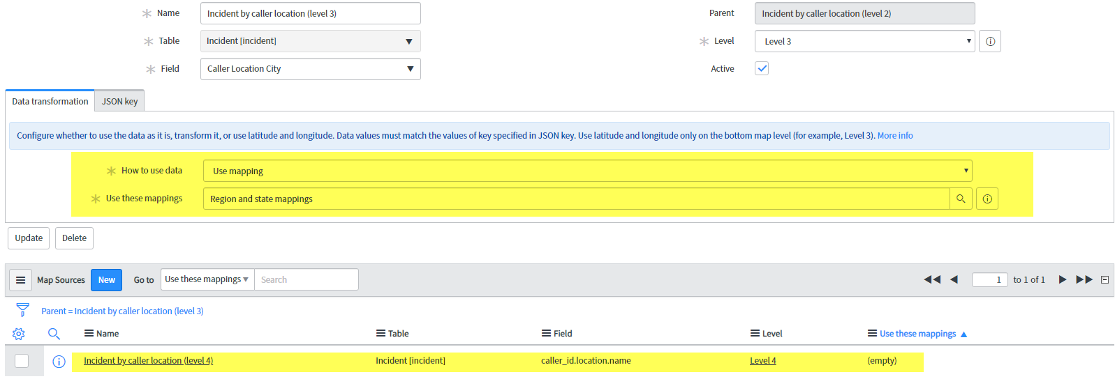

I finally managed to get what I was looking for by editing the OOTB Incidents by caller Map Source as below :
 Level 1 (unchanged) :
Level 2 (unchanged) :
Level 3 (edited) :
Level 4 (created) :
I can now display the map reports as below, both on my developer instance and on the two instances we are working with :
I really do not know if this is the right way to configure the map reports, but adding a 4th level resolved the fact the incidents where aggregated on one city per state.

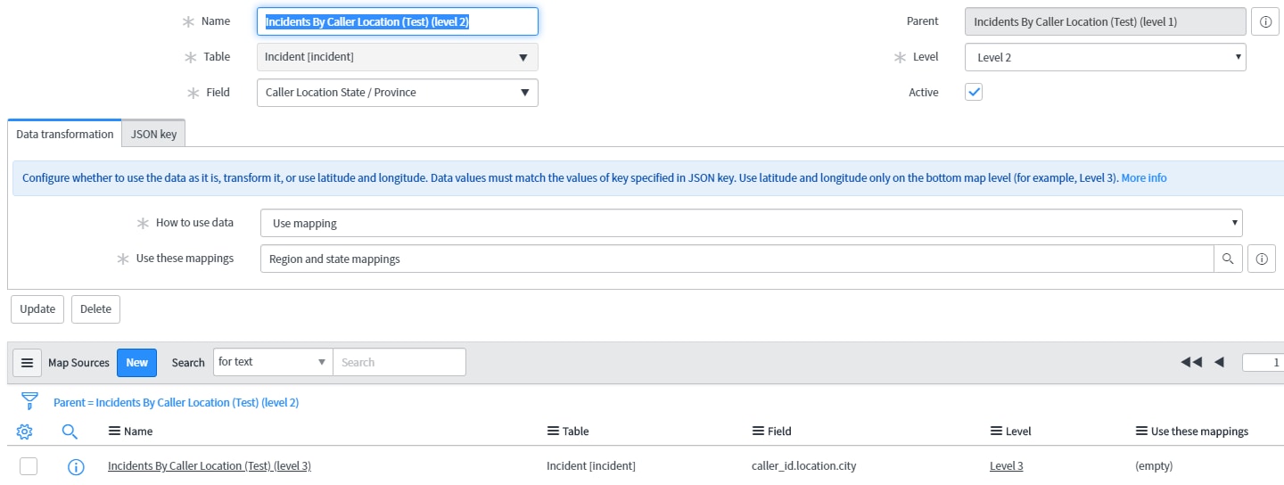

I finally decided to reset and wipe my developer instance, then I asked for the demo data deletion. At this point I would like to mention that the demo data clearing is not perfect : some locations where still present, some warehouses also (the warehouse were linked to the undeleted locations). Please remember I am using a Kingston instance, that should be important. After that I edited the OOTB "Incident by caller location" Map source in order to replace Caller Location Name with Caller Location City on the 3rd level, then I created the Region and state mappings for Canada, as below (and I also edited the map of Newfoundland and Labrador in order to replace the hc-key, which is wrong, from ca-nf to ca-nl) :

The map report  was created using the Incident by caller location Map Source (previously modified as noted above), and I get the data well displayed on every level (great !) :

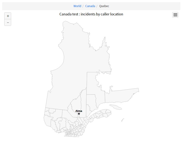

If I add another city, for instance Alma, and her City Hall as a child for the last level of location hierarchy, Alma will be displayed :
At this point, I cannot display several cities per state/province as ServiceNow appears to display the first city point in alphabetical order, for the corresponding state/province, whether incidents are related to it or not.
Level 3 (edited) :
Level 4 (created) :
