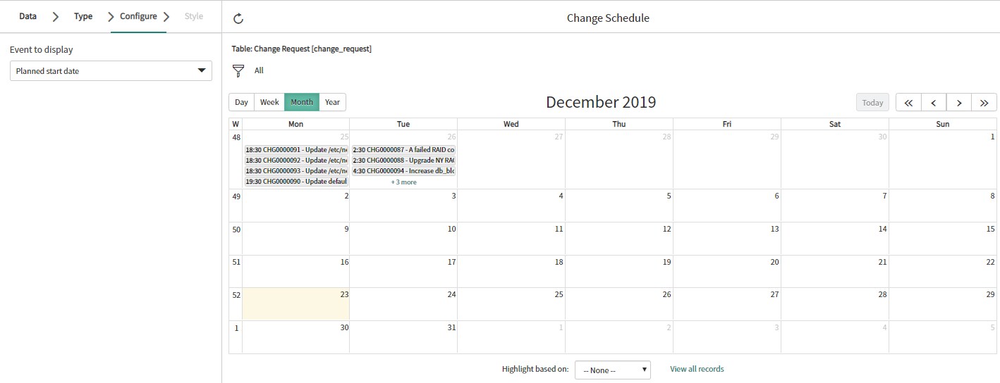

‎12-23-2019 03:18 AM
Hello jsn92
Create a report (Calendar type) and select event display as 'Planned start date' and you should get a display like this which shows you the change schedule per date. You can then add this to a dashboard... Is this what you're after?
Is this has resolved the issue please mark as correct or mark as helpful!
Also, have a Merry Christmas.
