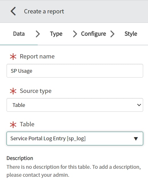

01-30-2022 07:39 AM
Also to note here there is another table named "SP Log (sp_log)" which captures specific details about say each page which a user had accessed and you can also a build a report on this as well.
Report Type : List:
Refer to screenshot below on how this would look like:
Shloke
