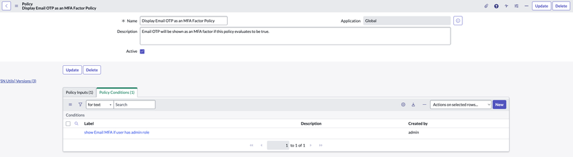

On MFA Context, the MFA Factor Policies are configured :

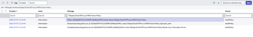

To verify this, you can enable the adaptive auth debug property in the instance and search with either the Email Factor policy name or policy sys_id. If the policy evaluation result is coming as true, then it wont even show the MFA setup page and it will redirect user to validation page - validate_multifactor_auth_code.do

The answer is in the question itself. Although, the email MFA Setup option is not available in the Yokohama release, the admins can still configure the MFA Factor Policy for Email factor to enforce the Email Factor for the specific set of users.
"For some users we want to use the Email Authentication only."
For this set of users, you need to configure the above Email MFA Factor policy in such a way that the policy returns true for such users. The Email Factor policy should be set to active to be effective.
Lets understand it with an example -
I want itil role users to use email factor only.
In this cases, I will create a role filter criteria with itil role (lets say - "hasITILRole"), add this filter to the above poliy as policy input and set "hasITILRole = true" in the policy condition so that the policy returns true for ITIL users.
This will make sure the users which have ITIL role will be directly taken to the validation page and they wont be shown the MFA setup page anymore.
