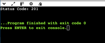

response = requests.post(url, auth=auth, headers=headers, data=json.dumps(payload))
# ===== OUTPUT =====
print("Status Code:", response.status_code)
Output:

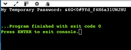

B.Retrieve Password from Logs:
This script is used to fetch the temporary password that was generated by the scheduled job and stored in the system logs.
import requests
from requests.auth import HTTPBasicAuth
instance = "https://<your-instance>.service-now.com"
username = "<admin_username>"
password = "<admin_password>"
auth = HTTPBasicAuth(username, password)
url = f"{instance}/api/now/table/syslog"
params = {
"sysparm_query": "messageLIKEMy Tem^sys_created_onONToday@javascript:gs.beginningOfToday()@javascript:gs.endOfToday()",
"sysparm_fields": "message",
"sysparm_limit": "10"
headers = {
"Accept": "application/json"
response = requests.get(url, auth=auth, headers=headers, params=params)
data = response.json()
for record in data.get("result", []):
print(record["message"])Output:
