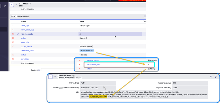

On that cloned HTTP Method - did you override the 'truncation_limit' query param "Value"?
  • It does have the dynamic $substitution / $string replacement format - but since you cloned that object for this job, you can override it with the explicit value you have with the actual value (e.g. "750")
  • Then your baseline Detection job would still operate with Truncation of 200 (using the dynamic substitution that uses the input from the Qualys int source config), and your tailored IG / InfoGath job would run with a Truncation of 750 that is a literal input (overriding the dynamic substitution / Qualys int source config).

One place of conflict for me is in the truncation limit - an API filter that is defined in the instance parameters, included in the Method list of items with string replacement notation, and set by (if I remember correctly) the set string parameter statement within the _buildRestMessage logic - where truncationLimit is the string name being used and truncation_limit is the API filter spelling of that ... my example is that we had to go down to 200 hosts at a time for the Detection integration, but I can run at 750 hosts at a time for the limited Info data we are after.
I have managed to copy/paste/edit all the components, the integration, its script, the HTTP Method, the report processor, and a few other objects to make a custom copy.  I didn't want it conflicting with the data sources of the original integration so I made a copy/paste/edit of those as well ... all seems to be working for me, but I am still not keen on just how all those places work in choosing a query versus string on setting the parameters, and when a field should be added to the integration parameters, or when hard coding of values in the method would work just as well.

Yes, Andy, while still wanting to better understand how it all links up, I did exactly as you are asking.  I hard coded 750 into the new post method I created for this cloned integration.  The one filter example was sort of easy to do that, and see the effects.  But I would still like to see better documentation that fully (clearly?) describes the linkages and how one item gets translated from the integration instance parameters to actual API filters without my need to get into the trial and error attempts to trace and understand what is happening.  Better understanding of what I was getting myself into could have saved a few hours of my time in cloning this thing.
