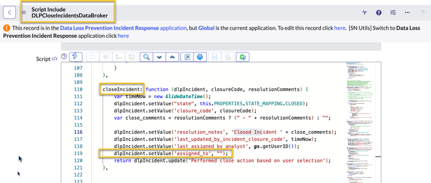

The baseline behavior today, is that the "Assigned to" value gets cleared out when the DLP Incident is closed.   You should still see that the "Last assigned by analyst" field gets updated to the value that was in "Assigned to".
In theory, there is no action pending for that person after the DLP Incident is Closed.
The "End User" Field should be getting cleared out though - that should remain static once it is set on the DLP Incident, even during Closure.

The Script Include -> "DLPCloseIncidentsDataBroker" has relevant logic here:
