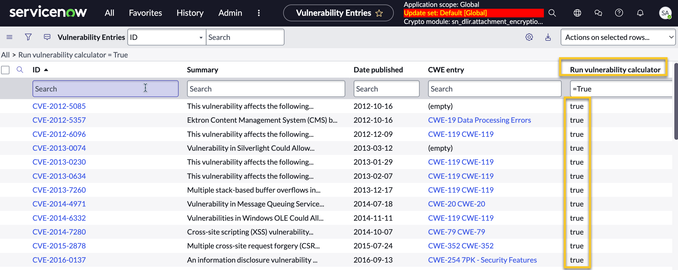

Can you check your records on the [sn_vul_entry] table, and personalize your columns to include the "Run vulnerability calculator" field to be visible?
You'll want to validate that your custom Biz Rule follows the logic of the 2 other Biz Rules mentioned above, and they are setting that field "Run vulnerability calculator" to <True> on the Vuln Entry records.

Where would I go to see that field set to true? I didn't find a field on the vit table for that. I think I also looked at records on nvd table.
Also the job is set to run at 2am. I have ran it manually and let it run automatically.

Thanks for your reply.
I have found the run vulnerability calculator field on the sn_vul_entry table and I have about 162 records with that field set to true. I have also found a CVE that is linked to open VIT records. I am monitoring those VIT records to see if their risk score changes.
