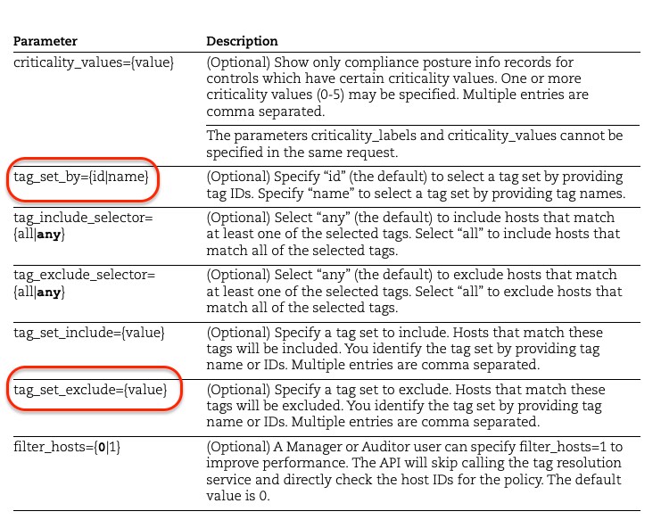

Fatih Karacaer
Hi Pinaki,
Here is the link to the Qualys API documentation.
https://www.qualys.com/docs/qualys-api-vmpc-user-guide.pdf
The query parameters you could use for exclusion is explained on page 698. (It is a huge document :))
The most feasible way to do is to use tags.
1- Tag the IP addresses and DNS names in Qualys.
2- Use the query parameter tag_set_by={id|name} set name or id in this field.
3- Use tag_set_exclude query parameter to provide the id or name of the tag you created on Qualys to tag the excluded assets.
4- Monitor your REST calls in Outbound HTTP Requests and see everything works as expected.
Please mark it as helpful if it is!
Fatih.

Hi Pinaki,
There is another thread on the forum regarding this issue.
https://community.servicenow.com/community?id=community_question&sys_id=1230ef081bcb4910acdc54e56b4b...
It looks like this is an interesting requirement from Qualys. Is there a tag which is added to all your assets. If so you can add that to the tag_set_include query parameter.
Or maybe contacting Qualys support and asking more details regarding the filter parameters is another option.
