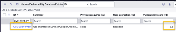

we are using both NIST ... (CVE Only) and TVM Vulnerability(CVE) integration, they both update National Vulnerability Database Entries (sn_vul_nvd_entry). The NIST NVD integration is executed first and TVM later (in couple of hours). We see number of CVEs missing V3_base_score despite having detections (about 800 out of 2200 published this year alone) and having CVSS in one of the sources (typically TVM).
Example can be NVD - CVE-2024-9960 score as 8.8 by CISA-ADP but the score is not adopted by NIST, while adopted by TVM:
What is suggestion here, can we get TVM to update NVD Entries originating from NIST, or should we stop using NIST NVD altogether? (or change the order of execution)

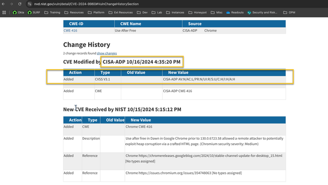

It looks like on Oct 16, the CISA ADP enrichment was updated, and I do see that CVE reflects the (CVSS Base Score) change in my lab instance.

LuKu
Not really, I don't see the score updated:
both NIST and TVM integration run multiple time since it was first created.

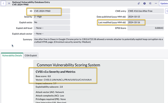

On another NOW instance with VR integration w/ NVD (v1.4.5)
  • I see the CVSS metrics mapped to the CVE-2024-9960 record (aligning to the ADP adjustment, where CVSS 3.1 base score is 8.8)

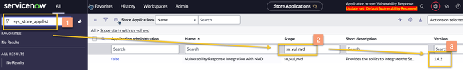

Can you clarify what version of the Vulnerability Response Integration with NVD you have running?
It could very well be a lingering issue that was addressed in a recent update, if you are running v1.4.3 or prior...
More context from the NOW Instance running v1.4.5 of the Vulnerability Response Integration with NVD, Store App...
When the NVD integration job ran on Oct 16, CVE-2024-9960 was included but had no metrics or CVSS scores
- CVE last modified = 2024-10-16T16:38
When the NVD integration job ran on Oct 17, CVE-2024-9960 was included - and it included the metrics + CVSS (c3.1) base score of 8.8... Aligning to the ADP scoring adjustment
- CVE last modified = 2024-10-16T20:35
