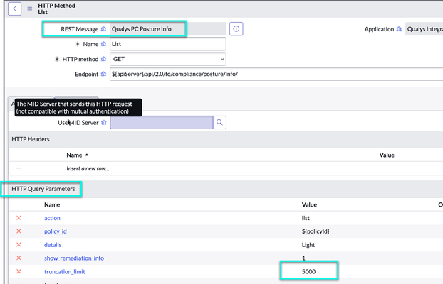

Given you have some trouble with the max processing time - may need to look at the pagination for the jobs (especially with that Comprehensive job).   I think baseline it is around 5000, could reduce this down to 3000 or 2000 and see if we get the files processing more quick (under an hour).   It will result in more files (less chunky) - but increases the chance of them being processed in under 1hr which is that limit you bumped into.

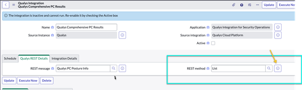

Nav to Primary Integrations -> Open the Qualys Results job (the regular PC one or Comprehensive) -> Qualys REST Details Tab -> REST Method -> open the record (Name = List)
On the Query Parameters -> try reducing down to 3000, 2000, etc...

Appreciate that perspective, Andy!  My truncation limit is set at 900 for the PC Results integration, and it appears that perhaps the Comprehensive uses the same REST Details method because it too is showing the same 900 value.
