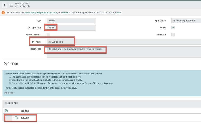

Out of box, it will require admin to do it. You will need to create ACL to grant other role access (need security admin to do that).
chrismcdevi
Do not delete the Remediation Target Rules, just mark them as inactive (active = false). The delete ACL is set to 'nobody' which means ServiceNow does not want you to delete this record.
