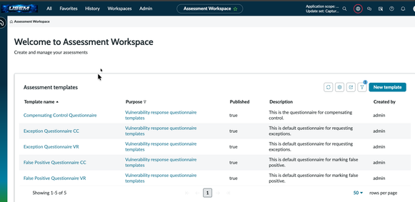

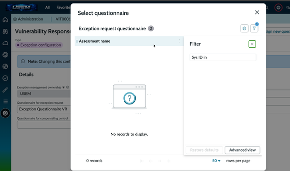

In USEM Exception Management when I click on "Vulnerability Response" under Basic Configuration ->Exception Management Configuration to select existing questionnaires the Select Questionnaire box is empty (no records to display) even though the Assessment Workspace shows they are there. This worked in VR, but no longer works after migration.
When I click on the filter for the Select Questionnaire box it says "Sys ID in"

I also saw this issue with the April 2026 release of VR (v30.3.3) in my lab

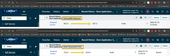

  • On that same instance, the issue was resolved with upgrading to the July patch release VR v30.7.2
  • Upgrading VR to the v30.7.2 also automatically upgraded the dependency Smart Assessment Engine (Smart Assessment Core) from 21.0.1 to 22.04 -> and then I saw the issue was resolved

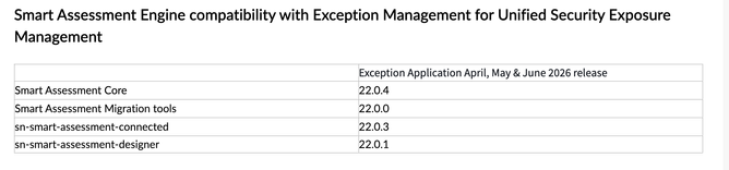

Our Internal Team has confirmed that the issue is related to a dependency on the Smart Assessment Engine (Smart Assessment Core) Store App Version, and has updated the VR Compatibility (Store App) Matrix to reflect this.
https://support.servicenow.com/kb?id=kb_article_view&sysparm_article=KB0856498
We could directly upgrade the Smart Assessment Core Store App to 22.0.4 and it should address the issue here.
Alternatively, upgrading to the July patch release of USEM VR v30.7.2 will also take care of this (it will true-up the dependency here).

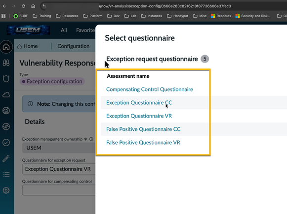

Reference - Reproducing in my lab with VR v30.3.3 (April 2026)
Reference - Relief after upgrading VR to v30.7.2

When you configure Basic Configuration > Exception Management Configuration > Vulnerability Response, the lookup should display the questionnaires created in Assessment Workspace.
In my testing, the Select Questionnaire lookup was also empty, and the filter only showed Sys ID in, even though the questionnaires were visible in Assessment Workspace.
This suggests that the lookup is driven by a reference qualifier that is expected to return a list of eligible questionnaire Sys IDs. If that qualifier returns an empty list, no records are displayed.

Installed the update and the issue is resolved. Thank you for you assistance.
