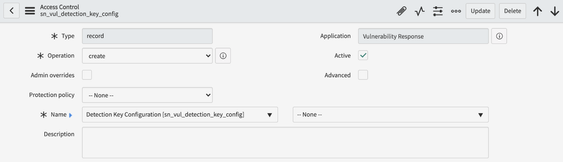

The Detection keys are purposely locked down - but to add a new one, you could de-activate the Create ACL on that table (sn_vul_detection_key_config) and create a new one for your new Integration Source.
Then create a new Detection key record for your integration.
Once you are done, for completeness, it'd be best to go back and re-activate that Create ACL (reverting your customization).
