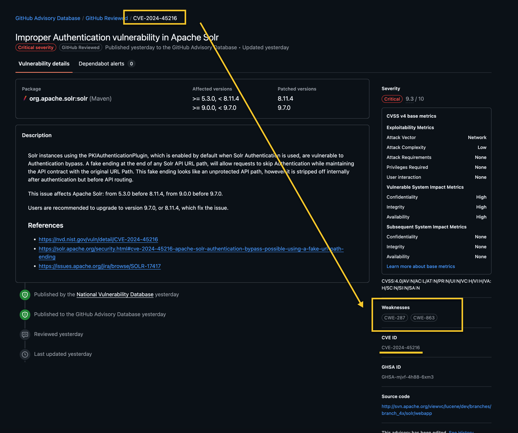

For the Code Scanning bit, I think you would want to see what type of data is coming form your intermediary tool - ideally they'd have something like a library with the GitHub Security Advisory, that links to one ore more CWEs ...
That would be used to create records in the Application Vuln Entry table, and then your VITs (would really suggest using AVR/AVITs, but I suppose this should work in VR/VIT would reference those in the Vulnerability field
For GitHub Dependabot Alerts / Vuln Advisories work, consider that a given CVE, may have one or more CWE tied to it.
You would want to leverage the CVE data for the Vulnerability on VITs
- https://github.com/advisories/GHSA-mjvf-4h88-6xm3

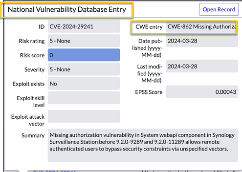

The Vulnerability Entry (sn_vul_entry) table - has the field for "CWE"
You will see certain records (e.g. CVEs) with a primary CWE populated there

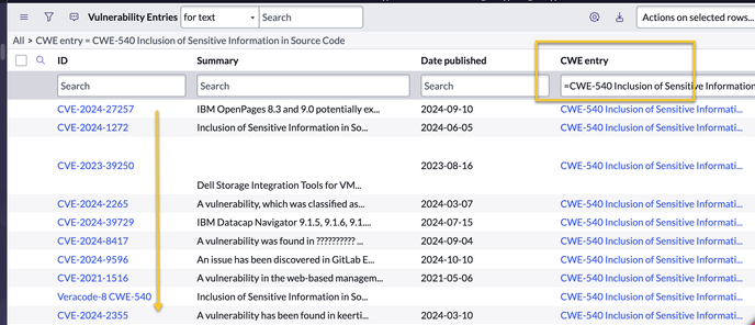

You'll see this presents several Vulnerability Entries linked to that CWE

I did the same search as you in the sn_vul_entry with CWE filter and the CVE matches didn't contain anything GitHub related. If there's nothing github related, how the vulnerability entry will be selected?
