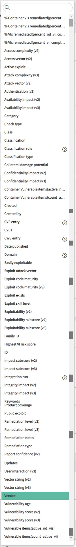

Problem is the CPE data doesnt seem to be available to select from in the condition. Am I missing it or is this not an option? I can see the CPE data in the Tenable System Import sets, but CPE is not being populated in the Third-Party vulnerability entry's or anywhere else that I can see. Is this possible?

The CPE data is on the Third-Party Vulnerability Entry table.
So, the CPE's Vendor and Product are copied over to the Third-Party Vulnerability Entry [sn_vul_third_party_entry] (i.e., your Tenable, Rapid7, Qualys, etc. vul library)... but the "Part" (aka Type: a,h,o) is not.
Vote up this idea so we can get the "Part" included in the TPE.
Until then, you will need customization..... the TenableTPEUtil Script Include. Customization should not be taken lightly and must be accounted for in each release.
Basic Steps
  • Add a new field to the TPE
  • Modify _processCpeData() (In TenableTPEUtil )
  • the "obj" variable contains the raw CPE data
