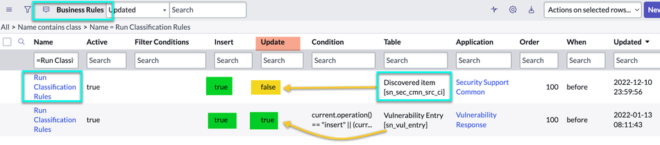

Baseline, there are two flavors of Classification Rules i) Discovered Items and ii) Vulnerability Entries.
In order for the Classification Rules to be triggered on each respective table - there is a Business Rule (on each Table), named "Run Classification Rules".
i) Discovered Items - Business rule, runs only on insert
ii) Vulnerability Entries - Business rue, runs on insert and for select updates
If you have appetite to align the Discovered Items Classification Rules (to account for changes), you could similarly update the business rule (Name = Run Classification Rules, Table = sn_sec_cmn_src_ci | Discovered Items) and model the condition to be similar to the one that runs on Vulnerability Entry (and toggle, the update flag).
Keep in mind - that even if the Classification Changes on the Discovered Item, it won't necessarily trigger other core configurations that have their own conditions for when they run (e.g. Scoring Calculator, Assignment, etc.)

Also does classification type changes on discovered items if resource tag does not contain external (currently if resource tag contains external, we classify discovered item as external asset) with OOB configuration?
We have noticed that the classification rule is not getting changed even if resource tag changes. I see two solutions for this:
1. Modify the business rule 'Run Classification Rules' to trigger it for update scenario as well
2. Reapply classification rules
Would like to know if you have any other suggestions?

Hey there - yes, this is what was reviewed above.
Keep in mind, with going with either option - it will result in updating the Classification values for the Discovered item - and you can use that in queries, reports, etc.   But - it won't trigger any logic like Scoring Calculators, Assignment Rules to be ran again.
