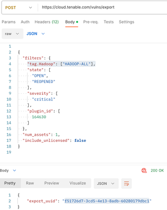

But it works fine from my REST API client.
 curl --location 'https://cloud.tenable.com/vulns/export' \
--header 'X-ApiKeys: accessKey=xxxxx;secretKey=xxxxx' \
--header 'accept: application/json' \
--header 'content-type: application/json' \
--header 'Cookie: nginx-cloud-site-id=us08' \
--data '
"filters": {
               "tag.Hadoop": ["HADOOP-ALL"],
               "state": ["OPEN","REOPENED"],
               "severity": ["critical"],
               "plugin_id": [164630]
"num_assets": 1,
"include_unlicensed": false

I had to use the script like this for  /* "filters": { "tag.Hadoop": ["HADOOP-ALL"] }; */
body.filters["tag.Hadoop"]=["HADOOP-ALL"];
