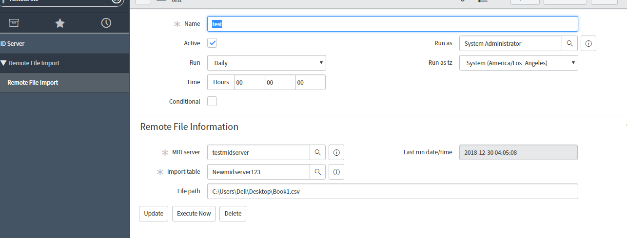

Hi shloke,
I have created the the import set table and gave file path, and midserver details.
I got the output in target table.
but could you please explain me the complete process how it is working through the script include.
or it is directly importing to the target table?
and please find the attached sheets
