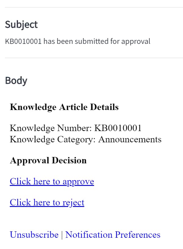

Hi Sandy,
You can update the mail script to basically write the content of your email for you, if you have a basic understanding of HTML.
Example below.

It's basically the same mail script as before, the only difference now is that it prints two lines which both have a string label.
Notice how in the notification I am only calling the mail script (highlighted in red). I could add some other text around it but that part of the mail script will always print "Knowledge Number: <NUMBER>" and "Knowledge Category:<CATEGORY>" on separate lines.
As for the Approval/Rejection links these are called via mailto email templates. You simply need to add the links in as below:
To generate....
Hope that makes sense
