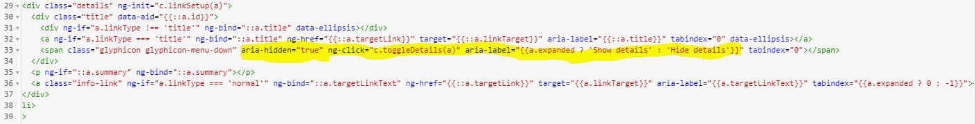

You need to do changes in announcement widget's HTML part to achieve this. Change the highlighted code with the lines mention below:
<span class="glyphicon glyphicon-menu-down" aria-hidden="false" ng-click="c.toggleDetails(a.expanded)" aria-label="{{'Show details'}}" tabindex="0"></span>

Hi Mohit,
I did try your piece of code in the HTML part of the Announcement widgets as below :
But it still did not work for me. Please help me understand if I ma doing something incorrect.
