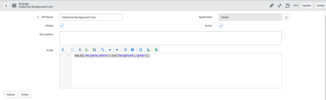

This can be done simply by Writing a UI Script as mentioned below:
Script:
top.$j('#sysparm_search').css('background','green');
Make Sure the Global Checkbox is marked True in the UI Script Form page as shown in the Screen shot.
Script:
