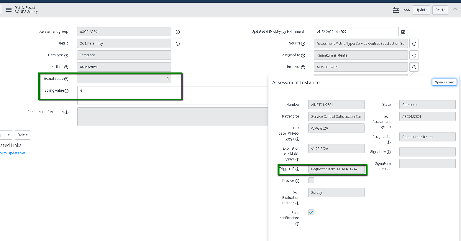

We are on Madrid version. We have requirement to send "Job Well Done" email to Fulfiller and his/her manager when the NPS score is 9 or more.
NPS score is stored on "asmt_metric_result" table and need to dotwalk from there to RITM's fulfiller and his/her manager so the email notification can be sent out. (snaps below)
Is it possible to dot walk on Users or Users Group field from asmt_metric_result table?
Please advise.
Thanks.
