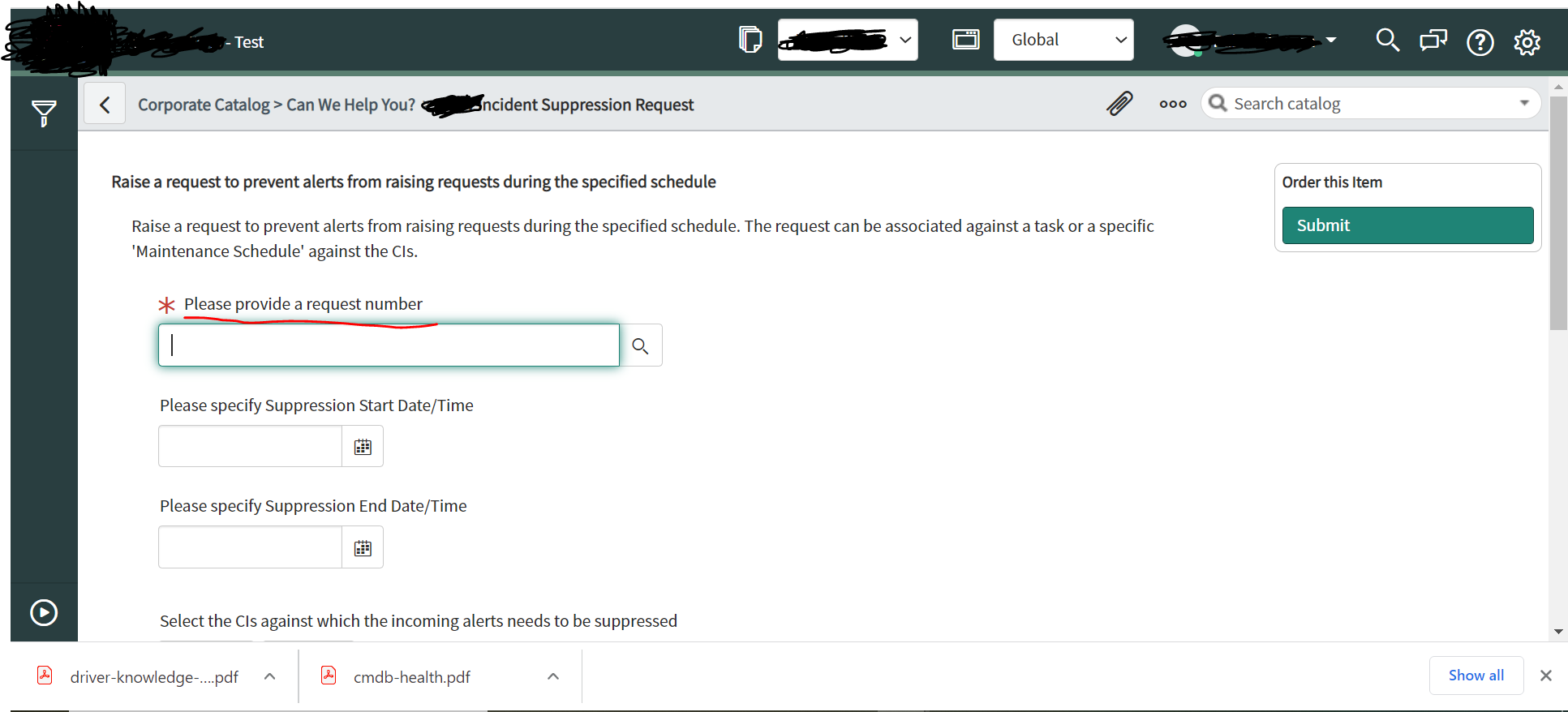

I am trying to populate fields from the incident where I have 'related link' to Service Portal page. The Service portal page has a reference to the task field where I am trying to populate the Incident ID.
So far, I have tried to embed incident record sys_id in the URL and also created 'onLoad' client script but it doesn't work (Followed this approach as mentioned here - https://community.servicenow.com/community?id=community_blog&sys_id=596dea29dbd0dbc01dcaf3231f96190b).
Catalog variable where the 'Incident ID' is required to be populated

03-01-2022 12:16 AM
Yeah I was able to solve it using the following steps :
1. Had forgot to uncheck the "Isolate script" on the catalog client script, so unchecked the option
2. Had to update the URL and replace '&' with '%26' after which I was able to get record sys_id in the URL
Updated UI action looks like below :-

03-01-2022 12:16 AM
