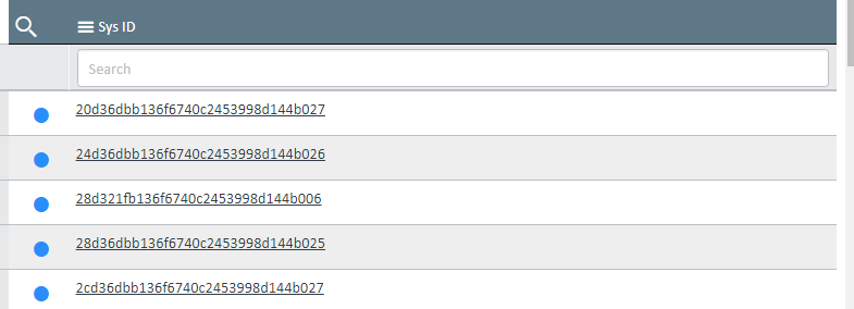

I have a reference variable on the catalog form and pointing to a custom table. I made one of the column display value is true. still it is showing sys_id when i tried to access the data from the reference field. Please find the screen shot blow.

Right click on the context menu beside the sys id>go to configure> list layout> select your field(It should be display true then only you can see it in the slush bucket)
which you want to display into the slush bucket and save it
Try this and let me know

It is working fine and helped .Thank you so much for the reply.

Navigate to that table and make Number/your required field display value to true.
Display Value
And i also see that you have only sysId show casing in your list view. Right click near sysId column and configure list layout
