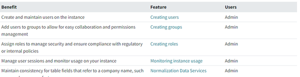

I create a report that indicates what roles does the users has but, what I want to know is which of those roles can edit users
Does only the admin role can edit users?

HI @Tona26 ,
From an OOTB perspective, it is only admin that can manage users on the instance: https://docs.servicenow.com/bundle/utah-platform-administration/page/administer/roles/concept/explor...
If you experience that any other users also can manage other users on the platform, I would look into the ACL for what ever that has been created (non OOTB).

Paul Porter
Users with the user_admin role can also edit user records, except for setting the Active boolean checkbox. The Active flag is read-only for a user_admin.
