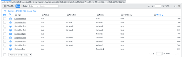

You can use containers in your variables to create a layout as needed. See the below example how its done.

Hi @jieLian123 ,
You mean the variables which are created in that record producer?
If yes then u can use order field to specify the value which is present for each variable. The lowest order variable will be shown at the top & the highest at the bottom.

Way 2:
