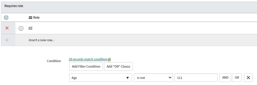

2. ACLs approach is as follows;
First Read ACL gives the read access of all records of this table to all users with the itil_admin role;
Second Read ACL gives the read access (to all users with itil role) of only those records of this table where Age != 111.
Hopefully this will resolve your problem.
