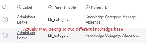

But now we find an issue, say if there are two same subcategory value in "kb_category", e.g. "Administer Leave",   which belong to two different knowledge base. Then above query will unable to retrive the correct record.
I think the best way to fix it is to add two conditions in the copy script.
1. Check and find record label = "Internal subcategory" in "kb_category" table (the script already done)
2. Check and match record in "kb_category" table's knowledge base value is same with knowledge article's knowledge base value
Unfortunately, I am unable to find how "kb_category" table is associated with "kb_knowledge_base" table, looks like Parent ID is not the one we want.
Can anyone pls advise ? Thanks.

Doing this through the Category / Category Parent ID is going to be difficult, because Parent ID can relate to *either* a Knowledge Base *or* a Category.   This is how you're able to have a KB with one layer of records and a KB you can drill into until your finger falls off.   There's no way of knowing how many tiers are between a category and a knowledge base unless you want to get into some real fancy iterations.
