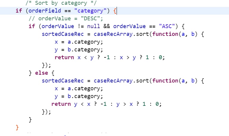

Hey Guys,
I figured it out. This is what i did: read the data with a GlideRecord and add it into an array. When I add the data into an array for choice fields I add the display values. Once I have read all the data I then sort the array using the display value of whatever choice field i want to sort with e.g. category in this case. I then return the sorted array and that is working perfectly as expected.
Here is a sample of my code for the sorting part:
Johannes

Hey Guys,
Johannes
