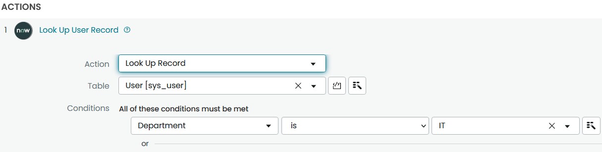

In this flow i had looked up for 2 records from the sys_user table in step 1 and 2 of the flow.
Hence in the code i have referenced _1_look_up_record & _2_look_up_record

Let me explain :
var user1 = fd_data._1_look_up_record.record.sys_id;
user1 is just a variable declared to store the value of sys_id field of the user record (sys_user).
As i earlier mentioned, in my Action 1 & Action 2 of the flow i have looked up for random user records from the sys_user table, one user whose department is IT and other  whose department is Customer Support.
Now that we have the user records referenced, we can use them using the fd_data object. It is the global object of the flow designer.
So, _1_look_up_record & _2_look_up_record; these record objects are created automatically.
You can refer to all the records from the previous actions using the fd_data object, just use the '.' operator (dot-walking) as shown below -
So again using dot operator we reference the fields of this record and we select the sys_id of the user.
Likewise for all users who are to added to the watch-list, create a variable and store the respective sys_id.
