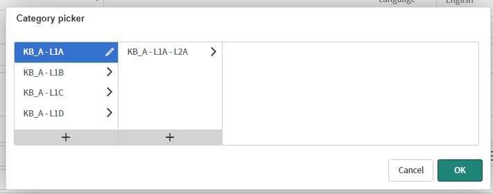

I'm having issues with setting up the KB Category Picker to work with a custom lookup table / form that I've created. The desired KB Category Picker that I want is shown below; it is the same picker that is used when creating a new knowledge article ("kb_knowledge" table). It is different from a regular list in that it allows you to drill down through the different levels of categories for the selected KB.
My table ("u_kb_category_to_approval_group") is extended from "dl_matcher" (lookup) and has the following three user-columns:
These fields all have the "u_" prefix because they are custom user fields. I want to have the same KB Category Picker for my "u_kb_category" field. The default KB Category Picker is handled by the "kb_category_reference_lookup" UI macro and "kb_categories_dialog" UI page. However, they both work with the "kb_category" and "kb_knowledge_base" fields whereas my equivalent fields include the "u_" prefix. As such, I had to create a copy of both the UI macro ("kb_category_reference_lookup_2") and the UI page ("kb_categories_dialog_2") and change them accordingly to reference my prefixed fields. The KB Category Picker dialog opens correctly for my form except it doesn't behave correctly when I select a category and press the "Ok" button; it doesn't acknowledge the selected category so an empty value is copied to the parent form's category field. I've troubleshooted and I don't believe that the "columnview_select" code in "kb_categories_dialog_2" client script is running as it should. It should be setting the hidden control called "categoryId" (in the dialog window) to the selected value each time a category is selected but its not. Your help in solving this issue would be greatly appreciated. Thank you!
The relevant code and configurations are shown below.

Had the same problem.
In UI Scripts clone "jquery_columnview" script and rename it.
In cloned UI Script search for "#body_kb_categories_dialog" and change it to "#body_<name of your dialog>" - in your case change it to #body_kb_categories_dialog_2
In UI Page HTML change include part to the changed name of the UI Script.

Thanks so much for your help Sam, this was the missing piece!
Wow was banging my head. Thanks for the solution!

I was doing exactly the same but the dialog was not initiated at all,
I see no errors in the console or anything
event the decorations itself seems not to be triggered or its breaking on the beginning
as it should  state on the loop icon "Lookup using picker"  but it says "Lookup using list" ans opens a standard reference list dialog ..
what could be the reason for that ?
