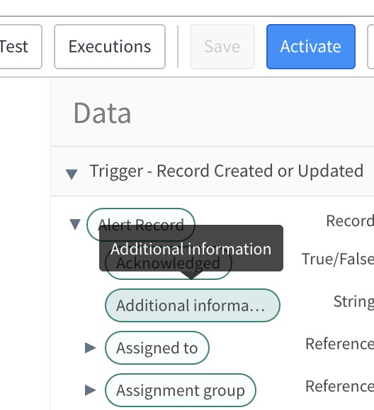

Here is how I achieved it:
- In the sub-flow added an input variable and label as id of type string.
- In the action of rest API, I also created input variable and named it the same as the above.
- From the flow designer, there was an option to add a script, the key was very hard for me to find. I have highlighted the green box.
- After press that button, we need to add the below javascript code provided by
@Ankur Bawiskar . But we had to get to our records which were hard to find in the first line. Note: if you are trying to parse some other variable than additional_info, change it accordingly. Try to use auto-completion.
var str = fd_data.trigger.current.additional_info; var obj = JSON.parse(str); var id = obj.id; return id; - Finally test the flow. It works like a charm.
07-01-2021 02:46 AM
so the alert is created and it has that JSON string in one of it's field
You need to parse that and store in which field or which record?
07-01-2021 02:51 AM
I want to create a new field and store it in that.
07-01-2021 03:04 AM
07-01-2021 03:16 AM
you can use script but where do you wish to store?
in which record and which field?
you cannot store it in some global variable just like workflow scratchpad variable
07-01-2021 03:20 AM
I don't know how to use the script feature in SNOW.
As long as I can use that variable to pass to Action for the rest API, I can store it anywhere.
