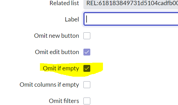

Go to Control Sub Category form, scroll down to the Threat scenarios related list. Right click on related list header and then click on configure --> List Control. You may see this Omit if empty checkbox is checked. if yes then please uncheck that if it is checked

On Control Sub Category, go to the List Control of Threat scenarios related list. There may be some condition set. Check that 'Omit if empty' checkbox is not True/Ticked.

Thankyou very much for your response and detail. I can confirm this works!
